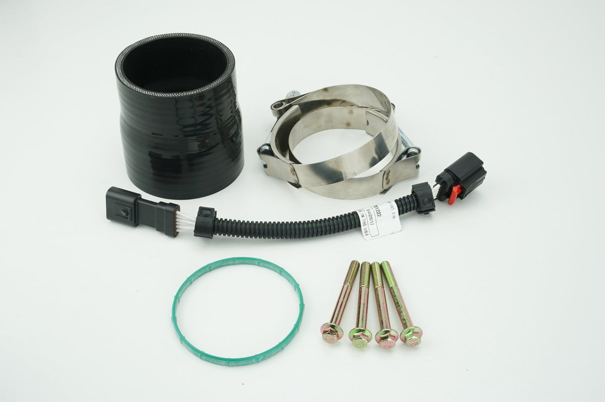

Thanks for the info. I will look into replacing the pipes. I was looking at replacing the throttle body with the RS one and add a spacer. They are supposed to improve throttle response and add some torque.
Discussion starter · #35 ·
I think it's the mustang throttle body that we use but I could be wrong.
Sorry, I think it is the mustang throttle body.
I had a spacer and has to remove it to install the cold pipe. The aftermarket pipe is larger than stock and being metal there is not much room to deviate from. Mine hit the oil filter if I left the spacer in place. I suppose it might fit if I cut short the silicon coupling hose, but did not want to mess with that.
Discussion starter · #39 ·
Did you feel a difference when you put the spacer on?
