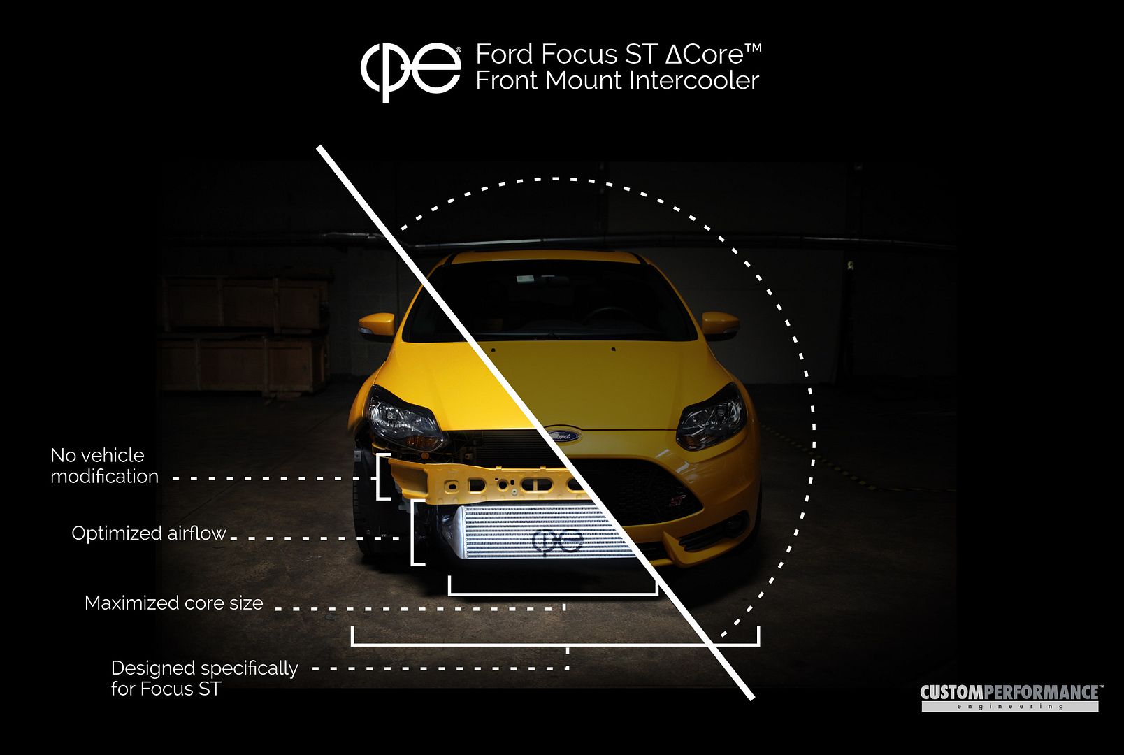

We wanted to give you guys a quick update on our new, bolt in front mount intercooler kit for the ST!
The intercooler features:
  • Cast end tanks with internal turbulence reducer connect to factory intercooler piping
  • No modification to bumper support required, 100% bolt in
  • Largest core possible
Production has finished and the kit is on track to be released in the upcoming weeks! Stay Tuned for release date, pricing, and dyno graph!

Hopefully I'm not getting anyone in trouble here, but it turns out there were a few unprotected directories for another host of that image... enjoy the pre-release goodness :) This looks like my favorite so far!
WOW That looks WAAAAAAAAAAY too thick. Honestly 3" should be max. I cant see how that is anymore efficient than its 3" counterpart.
#21 · (Edited)
End tanks play large role is how effective an intercooler is. Notice OE end tanks, where ends come off nearly flat with top surface - that is optimal. Sharp angle of end tank to intercooler does not promote good flow.
Other option to to use "backdoor" design and just dump the air into end tank and use resulting turbulence to distribute air across the voids. You need turbulence for heat exchange to take place. Flow will be function of area vs pressure differential.

Holy massive core, that is the thickest setup I have ever seen! Good thing the radiator can still get air from above, because no way that core is sharing anything through it lol.

Hey guys, my car is one of the test vehicles running this front mount and I don't know how much I can say, but I can confirm that there is no change in spool with with this core.
I was a little afraid that this core would cause a serious pressure drop, but the changes have only been positive. The charge air temps are way, way down, and the car actually picked up horsepower and torque even on the stock tune. I'm really impressed with the build quality, fitment, and performance with this core so far.

the shutters are removed
as far as i know the mounting points are the same as stock.
