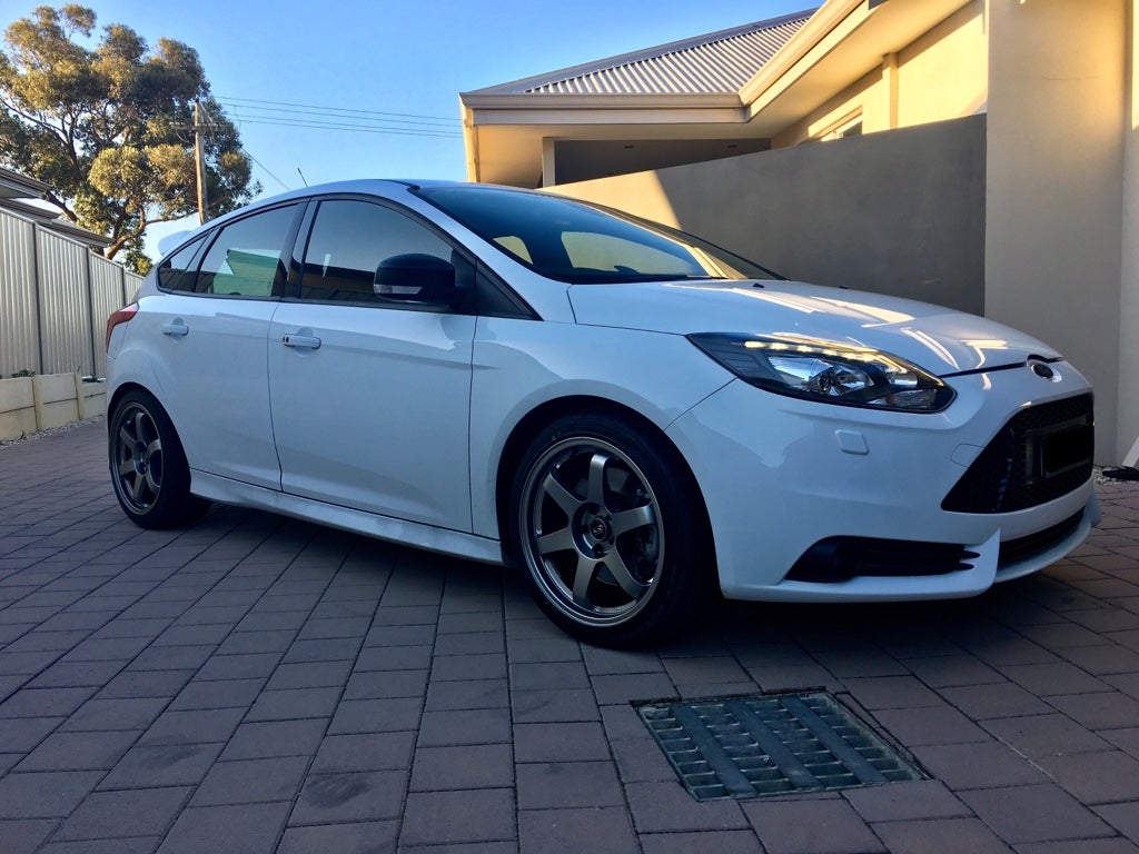

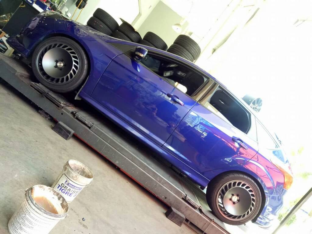

Nothing too special, just another ST with some Rota Grids.. Best I can get for the ever illusive 5x108 - especially being in Perth, Western Australia.
Happy with how they look and the fitment though. Much better than stock!
Matte steel grey Rota Grids 18 x 8.5 +40
Wrapped in Bridgestone RE003
Cheers

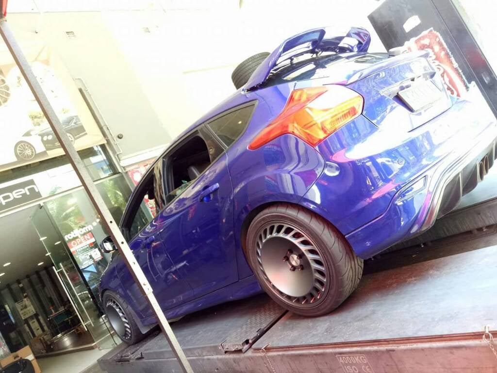

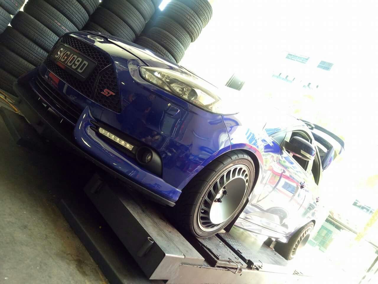

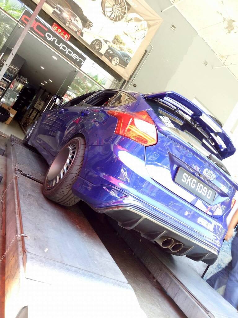

Particularly telling is the shot coming down the corkscrew with left side fully loaded. At full compression, there is very minimal but complete clearance between outer fender and tire. I think the +48 offset is necessary for complete clearance when running a 255 or higher tire. As some other members stated they are successfully running +38 offsets on track, I think this is dependent on the fact that they are also running 235 tires. Just my 2 cents.
Photos courtesy of Dito Milan, gotbluemilk.com

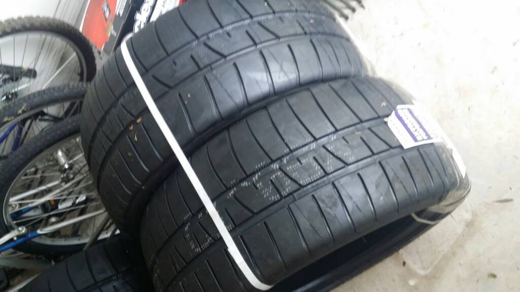

Tires are Toyo R888 255/35-18
100% agree, their stock tires stretch on the wider fitment allowing clearance. Gotta have that extra meat for grip. 255's are whats up, I think these specs are perfect! Nice job and car. Stock suspension is great for daily/track.

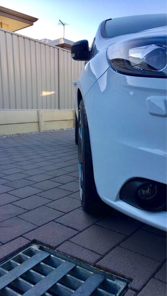

Cheers
