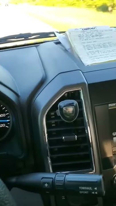

Okayyyy, long time no see. I picked up a 2019 f150 2.7 ecoboost as a new daily with a 4/6 drop on 24” Giovanna’s so some funds were rerouted for a little bit too. The sidewinder is completed and ready to go. The entire setup is stainless and a 3” stainless exhaust all the way back. Everything is vbanded for easy removal. We made 2 separate rear end pipes. One is a 3” straight pipe and the other has a 9” race muffler and angled tip for the asphalt to help lower the decibel reading for sound limits on the track.
