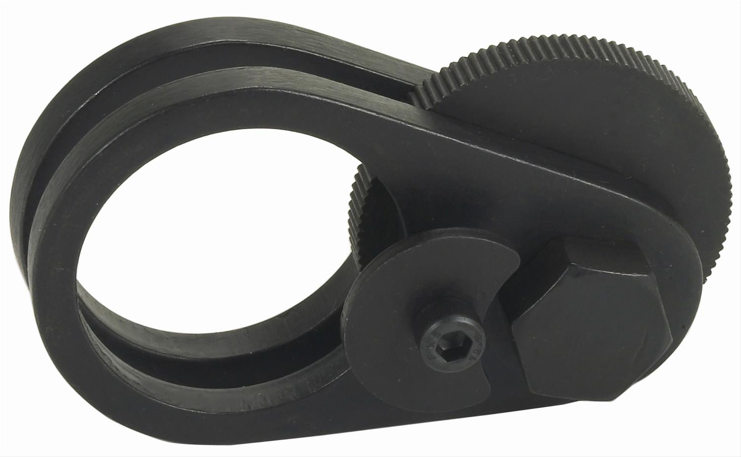

Picked up an inner tie rod end tool to get the original ones off--it's just wonderful that Ford didn't put a couple of flat surfaces on them so a normal inner tie rod end tool would work. I ended up cutting the tie rods to get the boots off instead of fighting the jam nuts.

#61 ·
How’d you like that inner tie rod puller tool? Did it work out great & easily for you?
#63 ·
It definitely did the job. It's not exactly the easiest getting the two halves in place and getting the nuts started, but no trouble at all getting them loose. The usual tool that slips over the tie rod doesn't work as there's no flat spot to wrench on, and in my case, I couldn't get the outer tie rod ends off.
If you're using it without disassembling as much as I did, make sure you have extensions to get the ratchet out past the brake rotor/hub.

@Duff i used this one on mine. Less cumbersome to get installed since its used as-assembled.
That does look like it would have been easier. Is it big enough to slide over the outer end?
I was expecting to have easy access to put a wrench on the inner joint right up until I pulled the boots back while the engine was out. The new tie rods ends had the flats, so it was a surprise when I got in there. It took several attempts locally to find the one I bought (and I'll readily admit I paid too much)--but it needed done before the new engine and stuff went in, and I'd only rented the engine hoist for a week.
Now I've got to decide whether I should buy that one from Summit next time I drive by one of their locations, or bet on never having to mess with them again...
