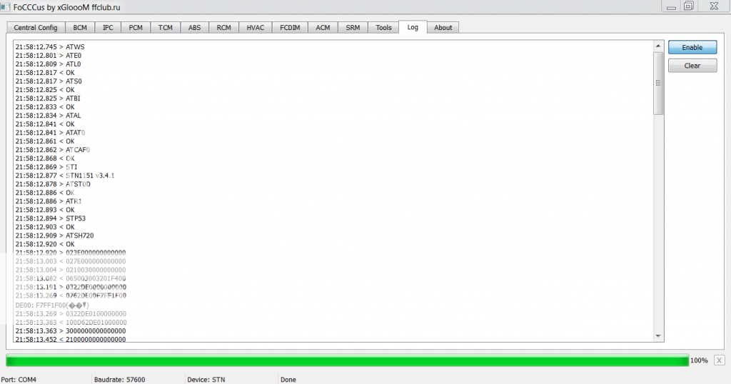

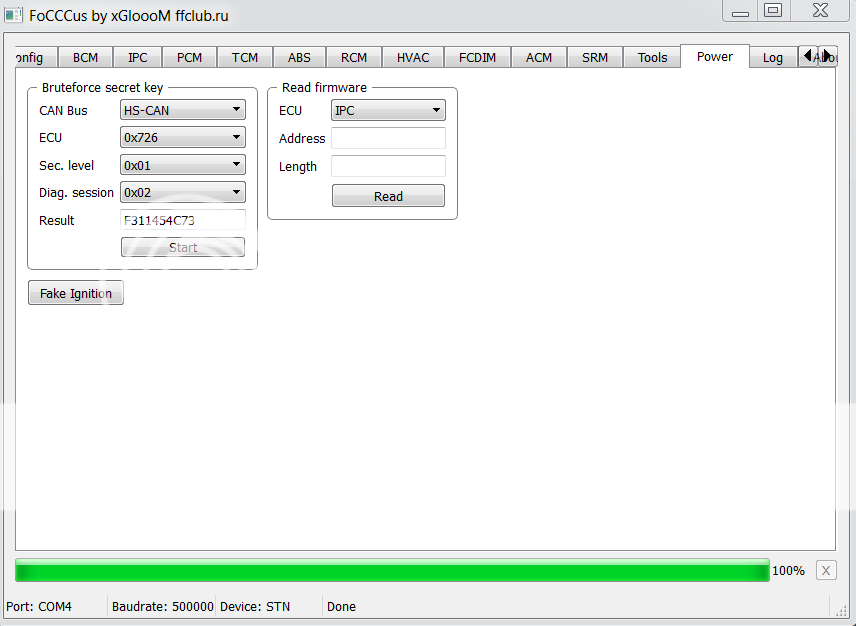

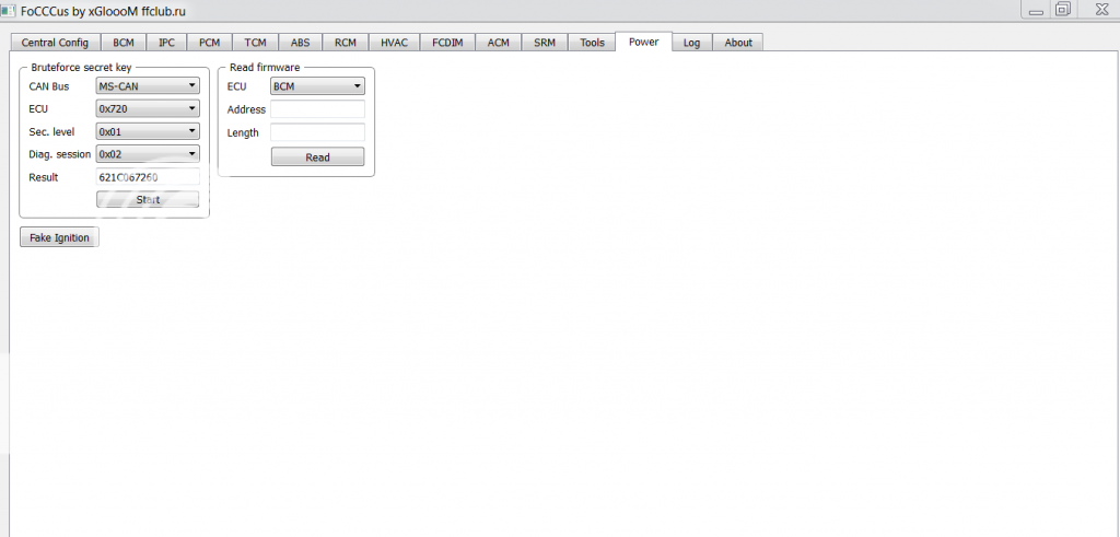

the pictures below are what is sent when in order the bruteforce the key. What exactly is the seed/key?
