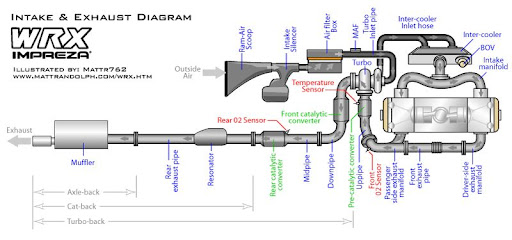

The diagram is for a WRX, but illustrates the difference between exhaust set ups well.
