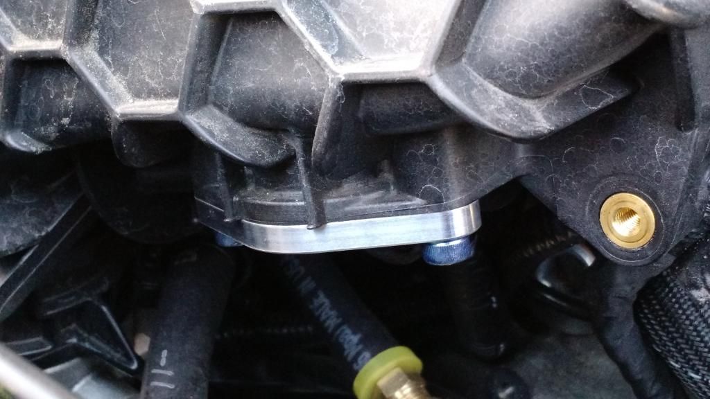

Here is a shot of the Sound symposer box on the intake manifold

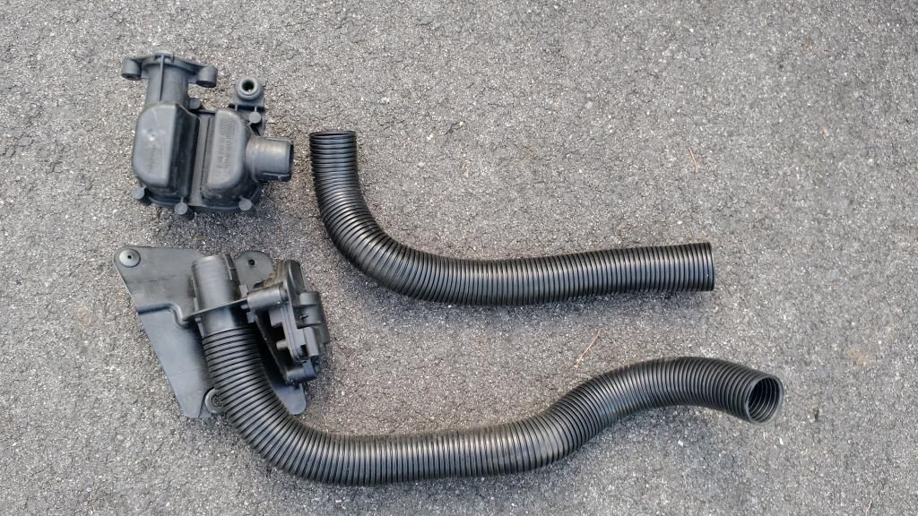

The block off plate will take place of this box. Installation is one of the simplest things! Remove the two screws that hold the box to the intake manifold and remove the box. Install the block off plate and use supplied screws. unplug the Symposer valve, and remove from its location and make sure you zip tie the wire for the valve up to ensure it does not get in the way of the gear linkage. Remove the symposer hoses and plug the elbow on the firewall. Viola! lots more room under the hood now!
Here is what you will have taken off of the car.

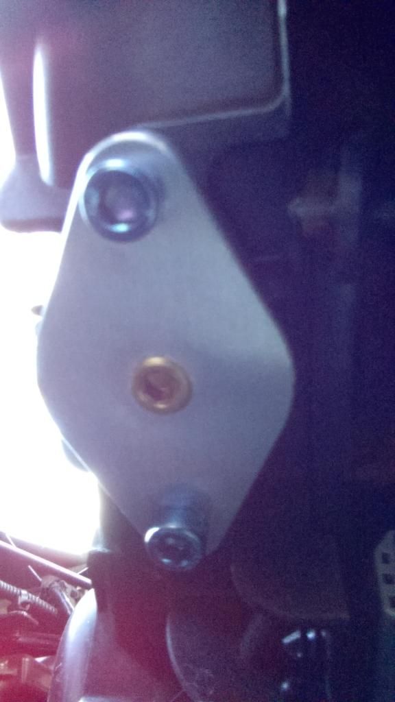

Personally I love the look of the kit, it is slightly visible when your looking under the hood. Damond also has a couple of color choices! Heres what Mine looks like installed on the car!
One advantage to this kit, Damond has included a threaded hole to allow for a fitting to read your boost! This is PERFECT for a Meth kit! Instead of splicing into the factory vac lines. The threaded hole can be seen in the following picture, where the gold plug is

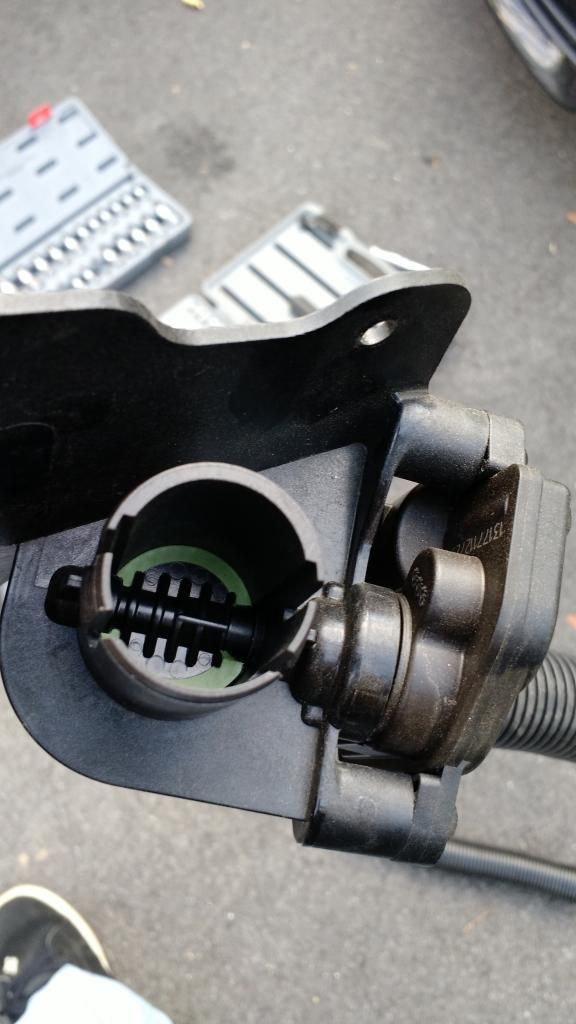

Here is the reason I say I recommend this kit in conjunction with the Oil Catch can. The catch can prevents oil from collecting in the intake manifold. As I found out when removing the symposer, oil makes its way into the symposer and the valve, with enough pressure that could put oil up near the cabin, and/or fumes.
In the following pictures you can see the oil.
