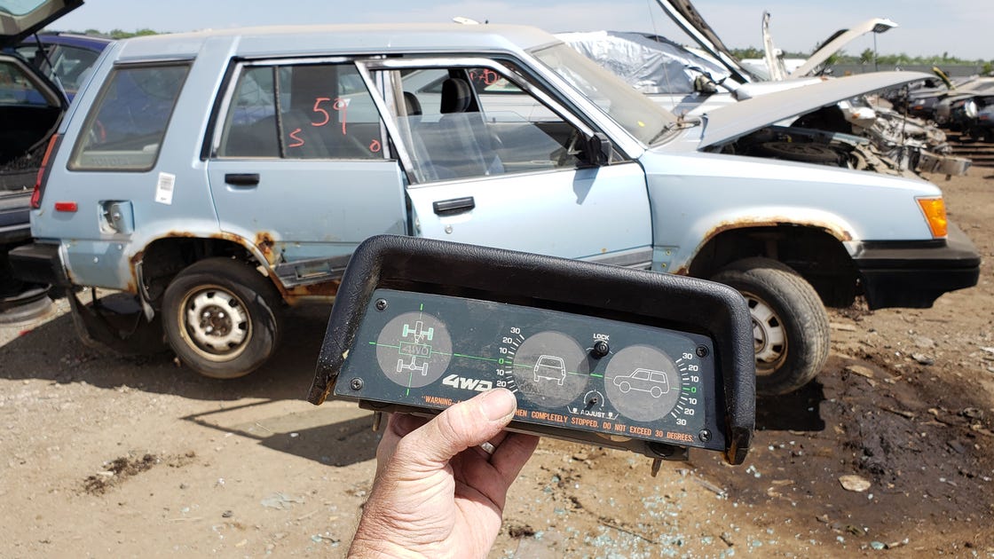

That makes me think we need a tilt meter, then we could see who could get the highest angle without flipping it?! 🤔😳🤣
When the Cheapo Tercel Got the Land Cruiser's Dash Inclinometer
