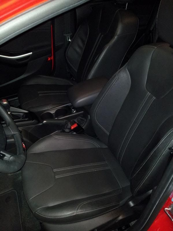

This guide is for swapping a Ford Focus ST 2's partial leather trimmed Recaro seats with the seats from a Titanium Focus. Only the driver seat can be swapped directly. The passenger seat electronics from the Titanium do not work in the ST. The easiest way to deal with this issue is to swap the upholstery between the ST and Titanium passenger seats. The steps for an ST 1 and ST 3 should be very similar. I would imagine the process would also be similar for a Fiesta ST as well. Over all the process is straight froward. Remove the bottom cushion, the seat back cover, and the foam. The frame and electronics are identical: size, shape, placement.

Put the seat in the car (remember to reconnect the plug box under the seat) and turn it on to verify the air bag light doesn't come on.

Major pain in the ass, but worth it. Love the look & feel of the Ti leathers.
