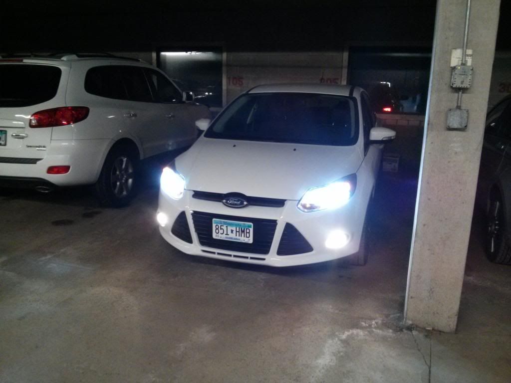

So in the end I added the global open and close and HIDs without resistors and no dipped beam fault. Very pleasantly surprised. (Also, if it matters I have a non-ST Focus).
