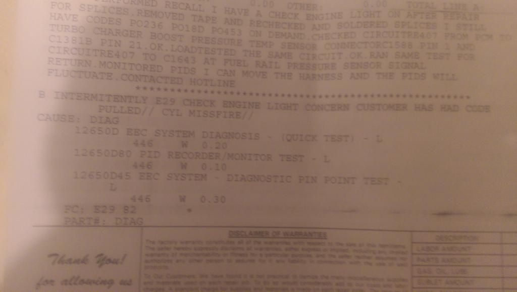

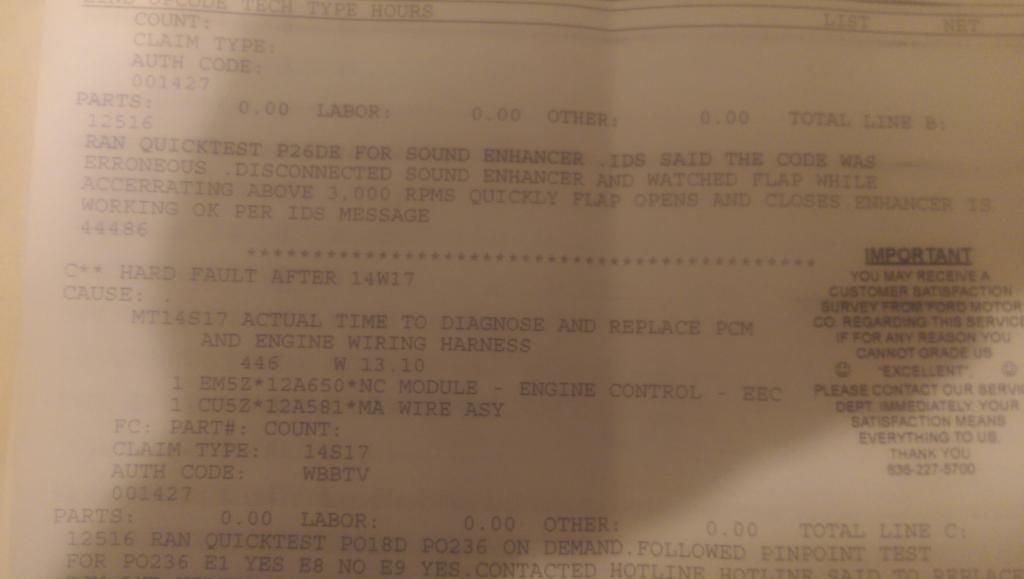

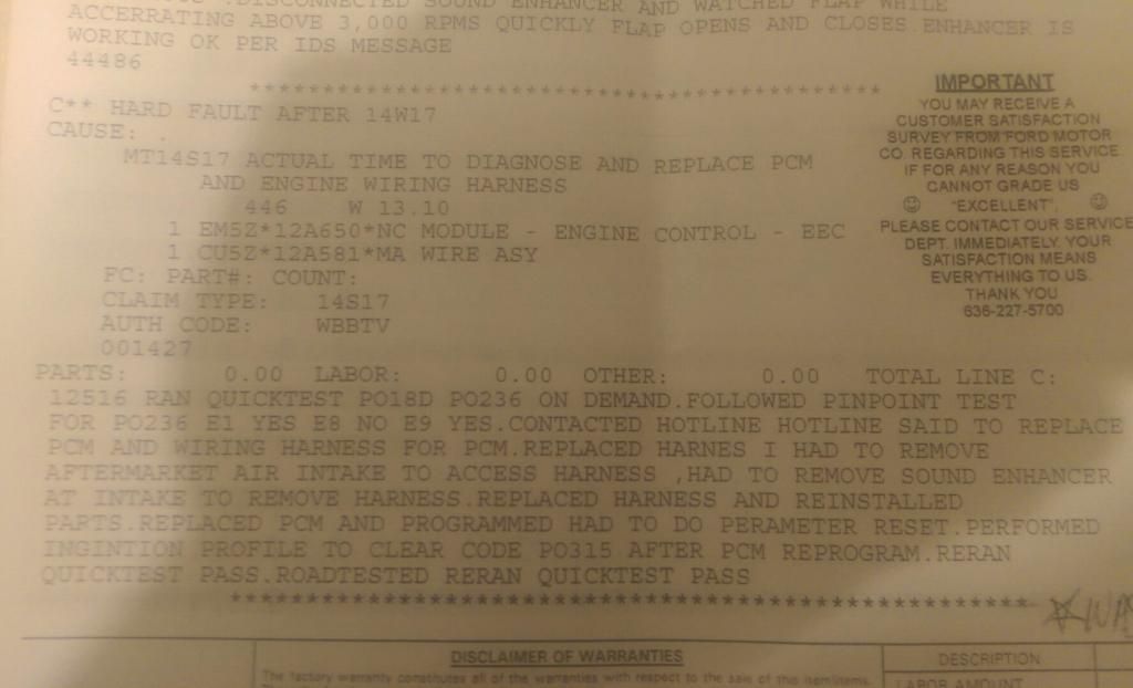

Hey there guys I thought I would share my experiences with you with my car. 2013 St2 ts. I had brought it in for the recall because I started getting check engine lights. Long story short, they had to replace the pcm and wiring harness after doing the recall. I thought I would share the details of what exactly went wrong for reference incase anyone is having problems during, or after their recall.
What was wrong:
What they did:
Sorry for the crap photos just doing this on my phone, if you guys would like better, such as typed out, let me know.
1,669 Posts
Sounds like you have a good dealership/tech. He went through the proper troubleshooting and still found problems instead of splice, solder, "here you go".
